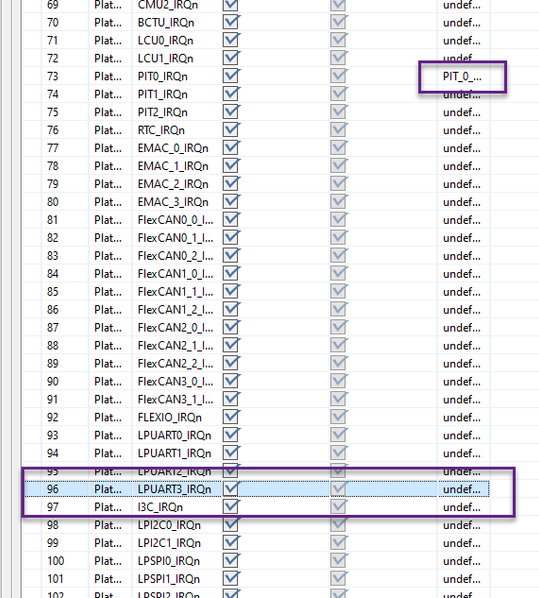

After successfully compiled and run, I added module LPUART to this project and assigned two ports for LPUART3:
And pretty default setting for LPUART module except change baudrate to 115200:

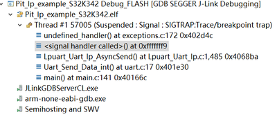

Then program always get hang at a Uart_Send_Data_int() function:

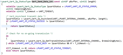

code for this function is pretty simple:
No idea of what could possiblly wrong. Only two interrupt enabled:  PIT0 and LPUART3. Still wrong after diabled PIT0.
For comparison I created another example:  LpuartFlexio_Uart_Ip_Example_S32K342.  Using previous function and everything runs well.
Is there any similiar story anyone encounted? Highly appreciate letting me know what's went wrong.

You need to define the interrupt hander:
LPUART_UART_IP_3_IRQHandler

towenyu
Thanks and your suggestion solved my issue.
Strange though I didn't manually input handler name, I guess it is automatically filled; somehow this time the tool didn't do that for me.
Maybe it is worthy to check the consistance -- as it has been check and enabled in "interrupt controller" page.
