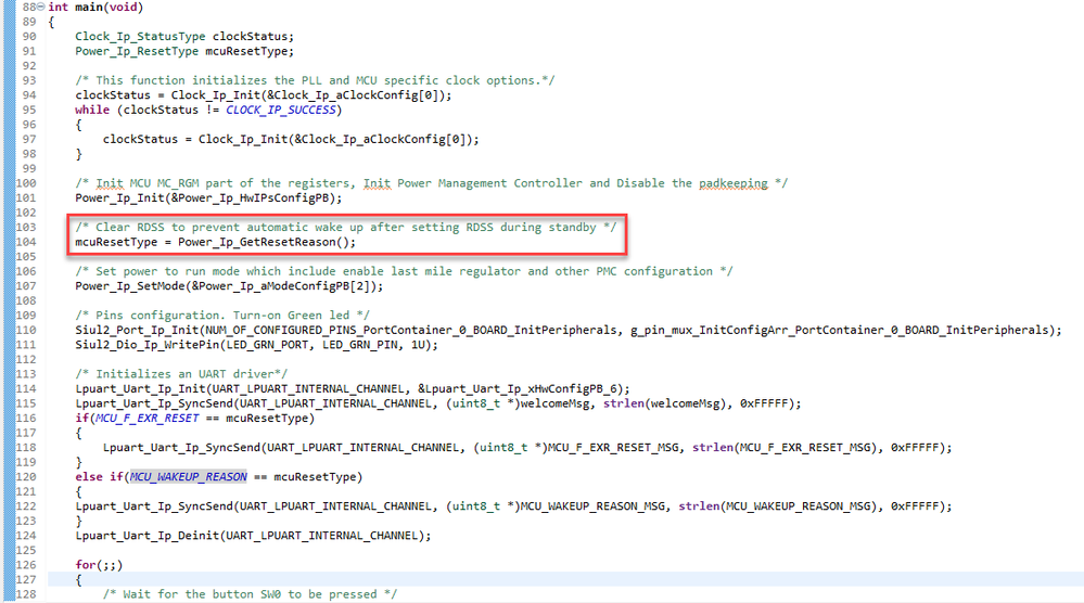

Julián_AragónM
Hi @the_chuck77,
I'm not sure what is the cause of this issue. I am unable to reproduce it on the S32K344-T172 EVB. Attached is the project I used to test the case. It configures the OpenSDA UART instance and prints the reset reason (in my case, only "MCU_F_EXR_RESET" and "MCU_WAKEUP_REASON" apply):
With this, no matter the timing in the WKPU channel 42, I always get MCU_WAKEUP_REASON, unless I completely power-cycle the board (with Reset push button), in which case I will get MCU_F_EXR_RESET.
Could you compare your routine for entering and exiting standby to the project attached? And if possible, test this same project on your board. It would also be helpful to share your project/configuration.
