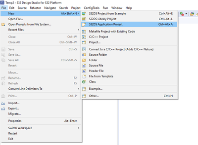

1.- Create a new S32DS Application Project

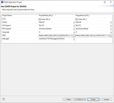

2.- Select your multicore device and give the project a name
3.- Select if you want to use the PlatformSDK or not... ( Personally I would use it since ir makes the development to go faster)

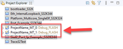

4.- After you click on finish, you will see that 2 new projects will be added to your project explorer tab. There is one project for each core, then you can compile them and develop them as 2 different projects.
