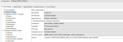

Thank you david! I will have a try. And have other questions :
1.Could you give me a guidance for FPU config? Because there are many options in every items. I don't know whether my config is correct.
2.Could you give me a demo about Put the Stack or heap into DTCM?

davidtosenovjan
1) You may let it default as you have it on the screenshot.

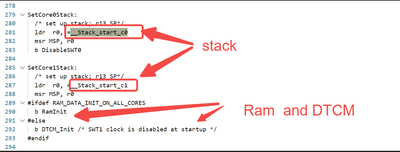

YEZIG
Thank you david!
I have successfully used the ITCM and DTCM ram,and also  successfully used the I_Cache and D_Cache.
But i still could  not use the DTCM as stack.
I modifed the link file to config stack ram address to the core's own DTCM region. But the Software  seems can not run .Should I also change the startcode,or other files?
my startcodes are as bellow:
Tags (2)
