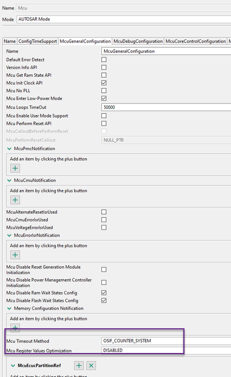

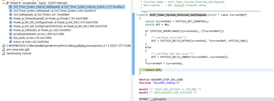

When performing Power_Ip_SetMode during initialization,
the time of OsIf_Timer_System_Internal_GetElapsed is not counted.
Where should I check?
SYSTICK_GET_COUNTER() value does not count.
I have an environment of S32DS 3.5, S32K324, RTD 4.0.0, FreeRTOS.
S32K3_RTD_4_0_0_P19_D2403_ASR_REL_4_7_REV_0000_20240315

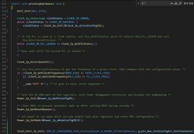

The initialization order of our system is as follows.

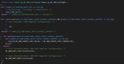

The arguments of Power_Ip_Init are as follows:
Please guide me.
Thanks.

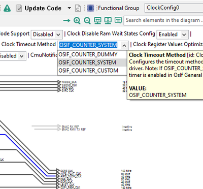

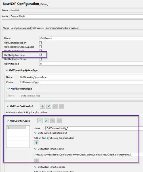

HI @jwkang,
Did you enable the osif system timer?
Clock
MCU
BaseNXP

jwkang
Thanks for your support.
But I don't use the Mcu component.
Because if I use the Mcu component, I should change many components.
Is the component needs necessary?
We are using freertos and non autosar system.

Hi @jwkang,
Unfortunately, not all features are supported by the IP drivers.
BR, Daniel
