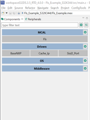

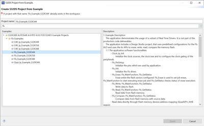

For FLS, you can refer to the Fls_Example_S32K344:
The driver is located in the MCAL layer.
Julián

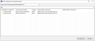

AnTran
Hello Julian,
As I check in the S32K324 the FLS driver is replaced by the Mem_Acc and ExFls and InFls is it right. Because in the config of S32K324 there is no Fls config for MCAL

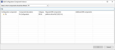

Julián_AragónM
Hi @AnTran,
Yes, this depends on which RTD version you are using for the S32K3:
RTD 3.0.0 (pre P07):
RTD 4.0.0:
