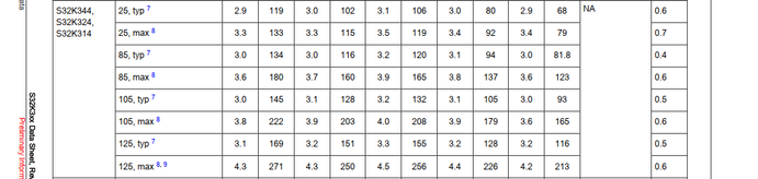

hemanths
How much will be the worst case (maximum) current consumption of the S32K324 microcontroller for a 3.3V power supply?

hemanths
Hi David,
I believe these tables are for 5V supply voltage. Whether any table like this present for 3.3V supply voltage?
Thanking you in advance
Hemanth

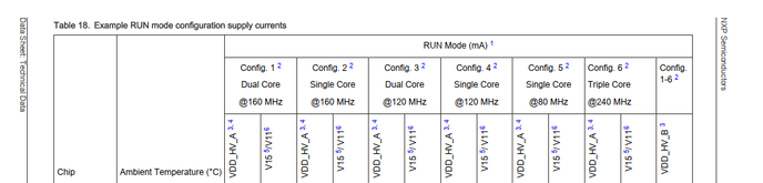

davidtosenovjan
It is not stated but it should be similar numbers. Of course that power losses will be lower.
1,639 Views
davidtosenovjan
You may find it quite well documented in the device's datasheet, Tables 17 and 18:
