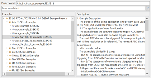

For S32k324, what is code for ADC module initialization and read result register w.r.t development board analog pin(ADCPOT signal)

Can you please share link for
Adc_Sar_Bctu_Ip_example_S32K342

Hi@Sanchita_Kochar
This demo can be found in S32 DS,I attached it for your reference!

Hi@Sanchita_Kochar
1.ADC Guidelines Spec and Configuration
https://www.nxp.com.cn/docs/en/application-note/AN13413.pdf
please take a look at the Chapter 5:SAR ADC Use cases.
2.RTD demos for your reference in S32 DS.
