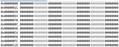

I have already implement the method into my code, but it seems like no data in ITCM memory area, do you know the potential reason?
550件の閲覧回数

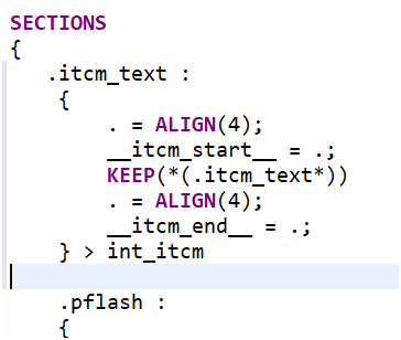

witness248
1. if I put itcm_text at the beginning of the SECTIONS, like below:
it can compile pass, but no data at 0x00000000

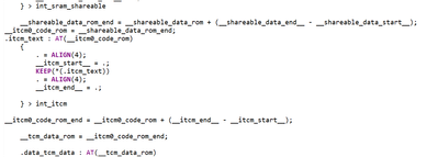

2. If I put itcm_text at the below location:
some compile errors happen.
