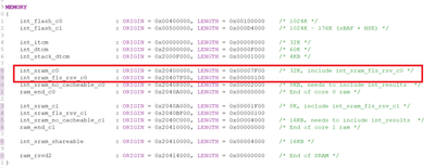

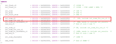

I have encountered some issues while using the S32K322 chip recently. The specific problems are as follows:
(Development Platform: S32DS. 3.6.2      Chip model: S32K322)
The program reported an error during compilation:
So I modified the size of int_stram_c0 in Project_Settings ->Linker_Files ->linker_flash_c0us32k322.ld
Before modification:
After modification:
After recompiling, there are no errors reported:
user01_4-1754884396085.pnguser01_4-1754884396085.pnguser01_5-1754884410688.pnguser01_5-1754884410688.png
But when I was debugging, the program got stuck in SRAM_LOOP in Project_Settings ->Startup_Cde ->startup_cm7. s:
SRAM_LOOP:
strd r0, r1, [r2], #8
cmp r2, r3
blt SRAM_LOOP
SRAM_LOOP_END:
This problem has been bothering me for a long time, but I have not been able to solve it. Now I need your help to provide an effective solution. Thank you very much!

Hi @user01,
Can you open the core register view and check the values in R2 and R3.
ldr r2, =__INT_SRAM_START (int_sram_c0)
ldr r3, =__INT_SRAM_END (ram_end_c0)
R2 is the start address of the SRAM region.
The loop is incrementing R2 by 8 bytes each iteration until R2 is equal to R3.
