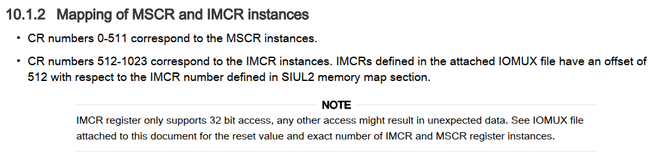

I need to use EIRQ[31] on PB17, If I need to configure this PB17 as external interrupt means I need to configure IMCR[559] but in S32K322 I have IMCR only up to IMCR[409]. How can I configure IMCR[559] in S32K322.

Hi @vignesh3,
This is specified in the RM:
BR, Daniel

How many IMCR register is there in S32K322.
that did not mentioned in RM, I need to config EIRQ[31] that means IMCR[559] I need to write but this register is not there in S32K322.

danielmartynek
Hi @vignesh3,
IMCR_512 (in the excel) is IMCR[0] in RM.
559 - 512 = 47.
Use IMCR[47].
I would recommned using the RTD drivers for that.

danielmartynek
Hi @vignesh3,
BR, Daniel

Hi @danielmartynek,
It is working thanks for the support.
