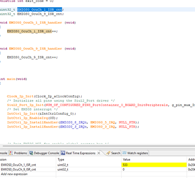

francescovico
Hello @Senlent ,
attached a simple project that increment two variable at each ISR of two SAOC.
The EMIOS0 CH1 increment counter EMIOS0_OcuCh_1_ISR_cnt
The EMIOS0 CH9 increment counter EMIOS0_OcuCh_9_ISR_cnt
How you can see the counter EMIOS0_OcuCh_9_ISR_cnt it's zero.
Regards, Francesco.

Senlent
Hi@francescovico
I tested the code you provided and it seems to work fine.
Attached is a screenshot of my test.
PS:I don't have a S32K322, so I tested the routine on a S32K344, which should be exactly the same

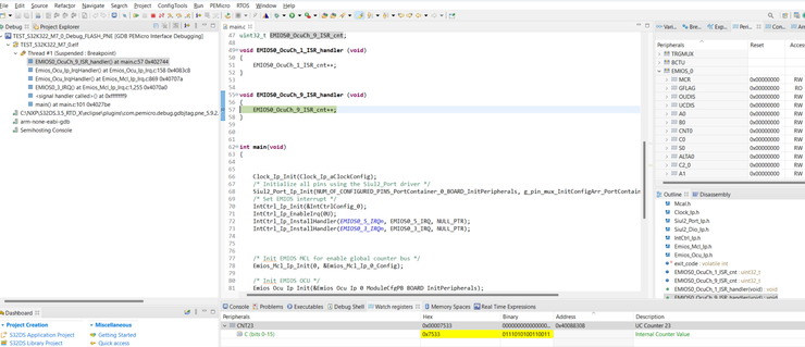

francescovico
It's very strange.
It's correct that CNT23 of EMIOS0 it's ever 0 ?
It's possible to have the .elf file of my project compiled using  S32K322 ?
I would like flash this elf file to see if it work fine.
Regards, Francesco.
906 Views
Senlent
Hi@francescovico
No, CNT23 should work, it shouldn't be 0 all the time.
and i have attach the "TEST_S32K322_M7_0.elf" for your test.
As i said before, i test your code in S32K344,not S32K322, but i think the result should be same with S32K322.

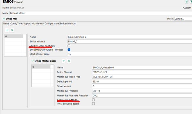

884 Views
Senlent
Hi@francescovico
It seems that there is a connection, otherwise I can't think of any other factors. It seems that eMios0-ch23 is not working.
Is it possible to download and run only "TEST_S32K322_M7_0.elf" only, without burning "TEST_S32K322_M7_1.elf",please have a try again.
Also, could you please change below setting and have a try again.
878 Views
francescovico
now It's working fine!
To work fine, it's necessary remove flag below:
This is a Bug in RTD ?
Thank you a lot !
 Francesco.
