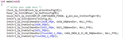

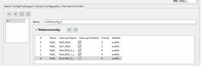

When i use ml-universa ,after configuring Flexcan, the program runs to undefined_handler.
But when I tried Jlink, even though I configured Flexcan, the program wouldn't enter undefined_handler.
And I stepped into debugging and found that the program encountered an error while executing the initialization interrupt service function. IntCtrl_Ip_Init(&IntCtrlConfig_0 -------->
if (pIntCtrlCtrlConfig->aIrqConfig[irqIdx].bIrqEnabled)
IntCtrl_Ip_EnableIrq(pIntCtrlCtrlConfig->aIrqConfig[irqIdx].eIrqNumber);
else
IntCtrl_Ip_DisableIrq(pIntCtrlCtrlConfig->aIrqConfig[irqIdx].eIrqNumber);
Here is my code and interrupt configuration

Is there any chance you could share your project or the configuration for it? As this issue is not reproduced in our side.
Julián
2,251 Views
zyc0211
sorry, i don not have S32K344. But i am sure the error will happen in IntCtrl_Ip_Init this fuction when i use multilink.Can u help me to solve this problem.

I am experiencing same thing when enabling only FlexCAN error IRQ like below
IntCtrl_Ip_EnableIrq(FlexCAN1_0_IRQn)
