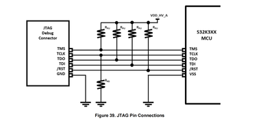

HI:
The MCU is connected according to the figure below, but simulation is not possible.

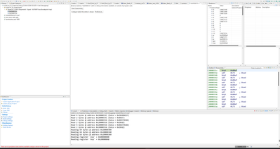

danielmartynek
In you first post, the screenshot indicate that the project was loaded and the execution was halted at a breakpoint in SRAM at 0x2000033C (PC register).
What is the error message now?
Can you share the debug configuration?
Can you place a breakpoint in the startup code (reset routine)?

youxi
Hi:
The attachment is the result output during S32K314 simulation.

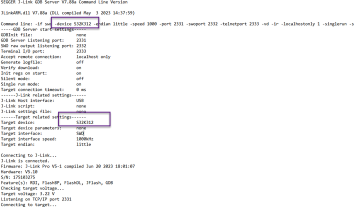

danielmartynek
Hi @youxi,
In the log, I see that the J-link tries to program S32K312.
I understand you have S32K314.
This would explain the failure to program it.
11,962件の閲覧回数

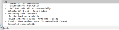

youxi
Hi@danielmartynek
I changed the device to s32k314, but still can't successfully

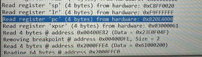

youxi
Hi @danielmartynek
The value of the CFSR register is 1.The address that the pc pointer refers to is 0x820E4000. I don't know what error this address represents
