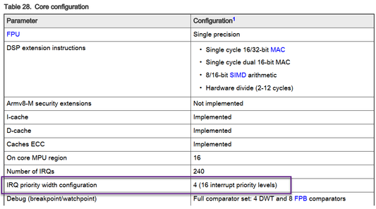

There are just 16 priority levels.

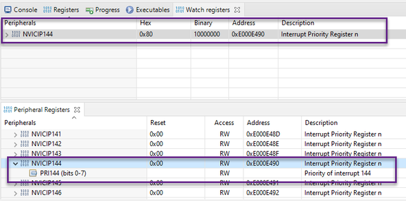

Double check the corresponding NVIC_IP registers.

The S32K3xx_Interrupt_map.xlsx attached to the RM lists all the IRQ numbers.
For example, LPUART3 has IRQ 144.
In S32DS, find the NVICIP144 register in the Peripheral Registers view.

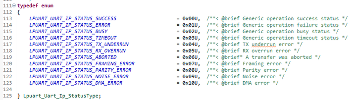

What is the return status of the Lpuart_Uart_Ip_AsyncReceive() function?
I am getting zero as the return status. I can see that the UART has received 1024 byes data but while reading I am getting only partial data with zero as return status.

I assume you use interrupts for both FlexCAN and LPUART.
For the LPUART we have set the priority as 4 by MEX file configuration and the FlexCAN interrupt is set as 20 using the NVIC api "NVIC_SetPriority(FlexCAN0_1_IRQn, 20)".
