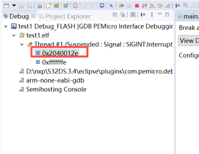

After program the relevant firmware for enabling secure boot, and after powering off and on again, the software remained at 0x2040012e.
What could be the reason for this?  Or is there any way I can find out the cause?

The device is in recovery mode. This mode is entered when: IVT is not present or corrupted or there are more than 8 consecutive functional/destructive resets or when secure boot fails.
In case of JTAG recovery mode, the device just hangs in endless loop in RAM, so user can take appropriate actions and the device is not bricked.
Based on your description, it’s caused by failing secure boot.

Common problem is wrong alignment of your application. Please take a look at this section from the application note:

The settings of IVT (0x00400000) should be correct, and the addresses of APP header and APP code are (0x004020c0) and (0x00402100) respectively.

The cause of the problem has been identified.thank you
