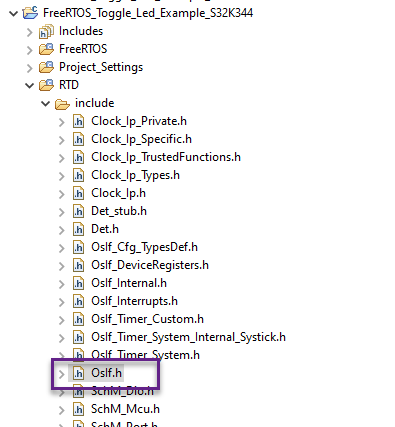

In the local project of S32K314, I tried to use “Manage SDK components” to generate freertos and osif code,but I didn't see the osif code being generated. (like “osif_freertos.c” and “osif.h” on S32K148 project).
How should I get the “osif_freertos.c” and “osif.h” files?

The RTD drivers are not compatible with the S32K1xx SDK.
But you can find osif.h in the RTD source code.
This is the FreeRTOS example:
BR, Daniel

In the osif_freertos.c/osif.h of S32K1xx SDK, OSIF_TimeDelay(), OSIF_MutexUnlock(), OSIF_SemaWait(), etc. can be generated.
But I don't see these APIs in the RTD source code.
Could you please tell me where or how these APIs are generated?

The RTD and the SDK drivers are different.
The functions you mentioned are SDK functions not RTD.
