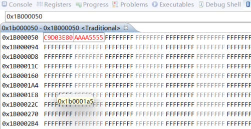

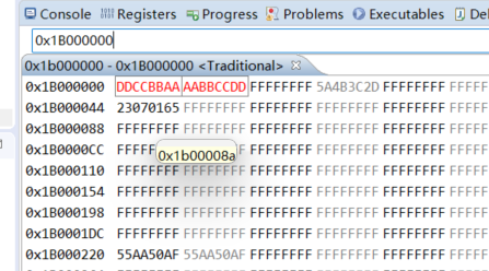

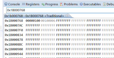

1.S32K314, External oscillator:16M, HSE firmware version:s32k344_hse_fw_0.5.0_2.40.0_pb230807.bin.pink
2.configure utest area: 0x1B000000 and 0x1B000050 already has been configured. DcfClockOption don't configure, because S32K314 have a default value ,meet option A(80M), you can see picture.
3.Then I configure advance secure boot(SMR and CR table), based AES128CMAC algorithm.
4.If I set advance secure boot, after reboot, execute secure boot, it's ok. But If I enable PLL(TempIvt.bootCfgWord |= (IVT_BOOT_CFG_WORD_BOOT_SEQ |IVT_BOOT_CFG_WORD_PLL_ENABLE);) when configuring secure boot, after reboot, code can't run rightly, and S32K314 will reset continuously.
5.we has been test in 8M and 16M External oscillator, the result is same. Of course, the user core we has configured to 160M(HSE only can be configured to 80M[option A]).
Notes:when we use old version HSE firmwire(s32k3x4_hse_fw_0.5.0_2.1.0_pb220625.bin.pink),don't have this question.
this pictures is our utest value when use 16M External oscillator.
