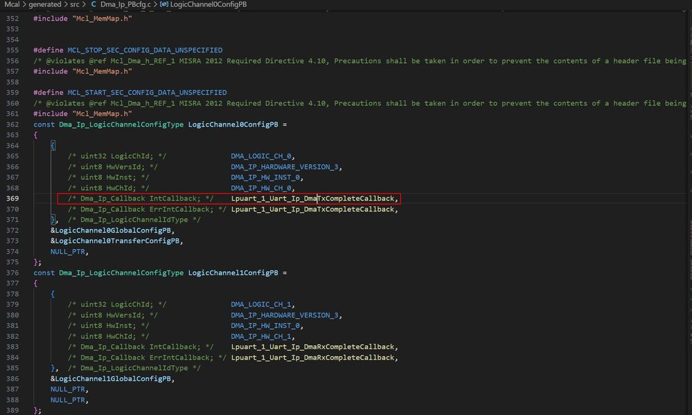

with S32K314, I am debugging Uart_AsyncSend on PIN140/PTC7/LPUART1_TX.
I plan to use DMA mode, the MCAL is generated with tresos studio 28.2
I can captuer the UART output data with oscilloscope, and the data is right what I send out.
But unfortunately, only one time transfer is OK.

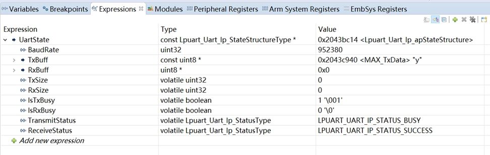

After one time transfer, UartState/IsTxBusy is always '1'.
BytesRemaining is always the data length of what I sent and won't decrease, although the data already appeared on oscilloscope screen.
I think it is caused by Lpuart_1_Uart_Ip_DmaTxCompleteCallback().
After one major DMA loop, Lpuart_1_Uart_Ip_DmaTxCompleteCallback() will be triggered by interrupt. Is it right?
With PE debugger, I can not get the breakpoint in  Lpuart_1_Uart_Ip_DmaTxCompleteCallback().
So I think there must be any errors to trigger Lpuart_1_Uart_Ip_DmaTxCompleteCallback().
could you tell me how to trigger Lpuart_1_Uart_Ip_DmaTxCompleteCallback() after UART DMA transfer completed?

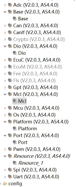

danielmartynek
Hello @gufengzi,
The RM driver is the Resource driver in your RTD 2.0.3 configurator.
Anyway, the NVIC ISER registers are configured in Platform_Init().
Do you call the function?

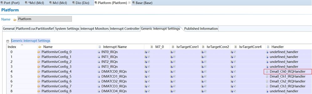

danielmartynek
Hello @gufengzi,
Did you enable the DMA interrupts in the PLATFORM configurator?
Thank you

gufengzi
I already checked DMATCD0_IRQn.

danielmartynek
Hello @gufengzi,
I don't see the handler funtions in the screenshot you posted.
An example is attached to the case, it is for S32DS, but the configurator is very similar.
1,036 Views
gufengzi
do you think the handler is Dma0_Ch0_IRQHander?
I already configured it.
1,017 Views
danielmartynek
Thank you, that looks correct.

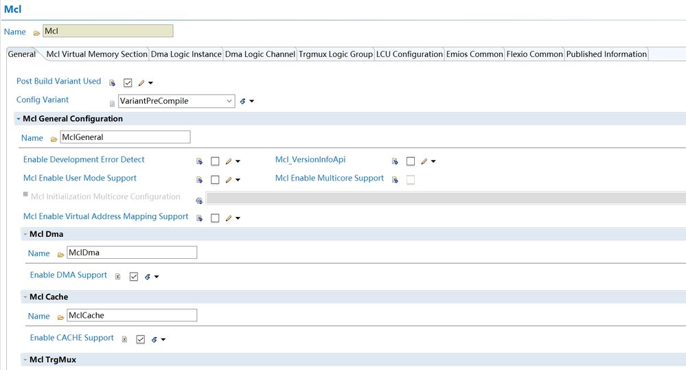

What about the DMAMUX configuration in the RM configurator, can you share it?
Or can you share the whole project so that I can check it and test it on my side?
If you don't want to share it here, consider creating a support ticket.

gufengzi
hello Daniel,
I can not find DMAMUX and RM in my EB project.
Sorry the whole project can not be shared. how to create a support ticket?

danielmartynek
Hello @gufengzi,
