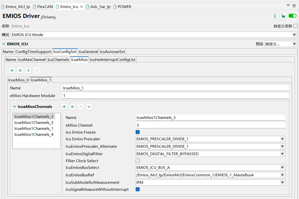

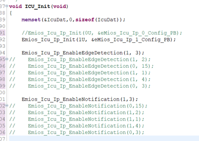

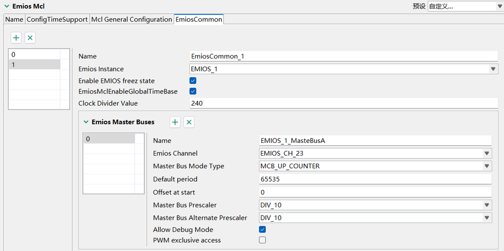

After configuring ICU and MCL, every time I check the IP_EMIOS_1->CH.UC[3].B value in lcuSignalEdgeDetection, it remains 0. Moreover, there is a significant difference in the subtraction of A2-A1 before and after each time. For example, after collecting IP_EMIOS_1->CH.UC[3].A three times, A1, A2, and A3 were obtained, with A3-A2=1000 and A2-A1=50,In theory, there should not be much difference between A3-A2 and A2-A1. May I ask if there are any errors in my configuration or calculation?

I referred to routine 【S32K311_RTD600_eMIOS_IPWM_Ip_example】, but I noticed that there is a significant difference in the data collected each time.The actual square wave frequency is 50Hz, with a duty cycle of 50%
