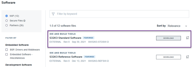

danielmartynek
Hello @gary_yang,
Can you install S32 Design Studio 3.4 and the RTD drivers?
It is available in the S32K3 Standard Software package:

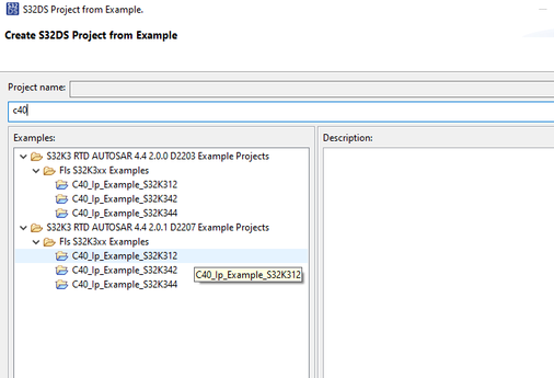

Once installed, create a new project from example:

danielmartynek
Hello Gary,
Do you have any other issues accessing the MCU via JTAG/SWD?
If not, are the sectors that you erase/program unlocked?
You can refer to the C40_Ip RTD examples.
