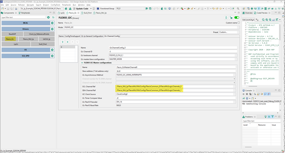

 I am using two pins as show above as flexio i2c,
when configure in EB, below errors occur.
I2c hardware channel used is FLEXIO_0_CH_2_3. For SDA Channel Ref select CHANNEL_3 of the FLEXIO device
I2c hardware channel used is FLEXIO_0_CH_2_3. For SCL Channel Ref select CHANNEL_2 of the FLEXIO device.
In hardware design, acturally using CHANNEL_3 as SCL and CHANNEL_2 as SDA.
Is there restictions that "The SCL channel must always be the lower-numbered channel in the pair" in S32K312?

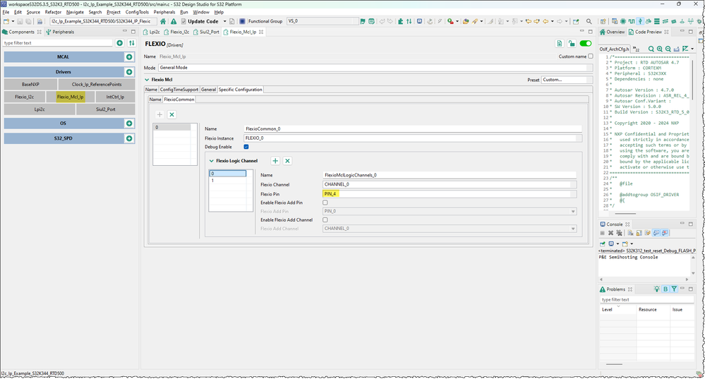

Please swap the pins in Flexio_I2c or Flexio_Mcl_Ip.
