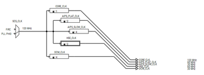

Adrish
Hi @PetrS
Can you please explain how to set this clock at 60 MHz. At present I see it set at 120 MHz.
I tried to change the frequency using the graphical tool inside the IDE but it showed me an error.
I'm using s32ds3.5
3,244 Views
PetrS
just set divider to /2
BR, Petr
