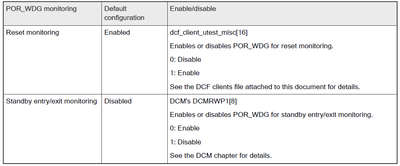

Anurag_Raghavan
What is the meaning of StandBy entry & StandBy exit.... ??
