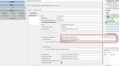

Senlent
Hi@Neo1096

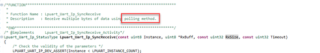

1.polling
2. Or
Lpuart_Uart_Ip_AsyncReceive()
while(Lpuart_Uart_Ip_GetReceiveStatus()==........)
3.Enable Interrupt
step1:Lpuart_Uart_Ip_AsyncReceive(0, Rx_Buffer, 1);//start receiver 1 byte
step2:In Uart interrupt handler
void Uart0_Callback(const uint8 HwInstance, const Lpuart_Uart_Ip_EventType Event, void *UserData)
	if(Event == LPUART_UART_IP_EVENT_RX_FULL)
		Rx_BuffIndex++;
		if(Rx_BuffIndex >= Max_Rx_length)
			Rx_BuffIndex = 0;
		Lpuart_Uart_Ip_SetRxBuffer(0, &Rx_Buffer[Rx_BuffIndex], 1U);//start receive process again
4.DMA+Idle,
This has been demonstrated in the previous answer.
The above are the four methods that can be thought of at present. As for how you want to process the received buffer data, this is an application problem and you need to find a way to solve it yourself.

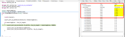

I sent 10 0As. The first one failed to receive, while the following 9 variables were correct. What could be the reason for this?
How do I know how many variables I have received in the timer interrupt?
The timer interrupt is 7500/30,000000 = 250us, and the baud rate is 115200. Shouldn't it only receive 2 bytes?

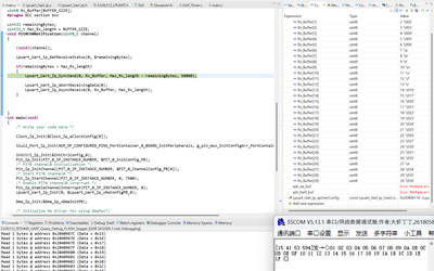

The code is attached.
1,418件の閲覧回数
Neo1096
In the array, five numbers were received, but the baud rate is 115200 and the timer is 250us. Theoretically, only two complete bytes can be received, so the remainingBytes is 28. I will lose the last three data.
If the data sent at one time exceeds the preset array range and there is no time to update it, one piece of data will be lost. For example, in the figure, if 1 to 32 is sent, only 30 can be received, and Rx_Buffer[0] cannot be updated to 31
