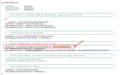

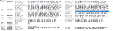

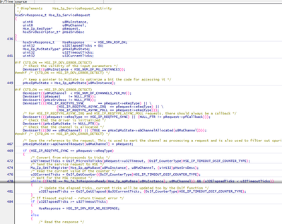

the program will alway stay in  pass App_GetHseAttrCapabilities to  wait the response. and about after 5 seconds, the cpu will reset by HSE_SWT_RST.

Do you have problems running the DEMO APP? Please check whether your clock configuration is strictly in accordance with the configuration of OPTION B. Please check if your firmware installation process is the same as that of the attachment. It is recommended to find another board, use the installation method of the accessory, and then try the HSE function again. If you use MCAL code, please check whether your code calls the Power_IP_SetMode function? This function is located in the Mcu_SetMode function. Power mode needs to be configured.

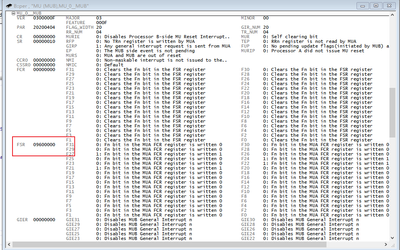

4.the FSR is aways equal to 0.
