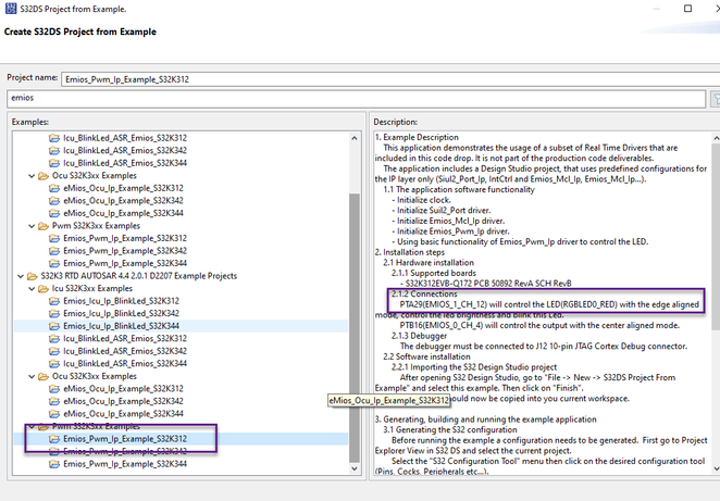

Hi @Alfredo_Rubio,
Do you initialize the EMIOS clock before the EMIOS?
There is this RTD IP example that utilizes EMIOS_1_ch12 and the LED for PWM.
Have you tested it?

Alfredo_Rubio
I ' have just checked for update and the last S32K3XX AUTOSAR version available is the 4.4 that I have already installed. How can I get the 4.4.2.0.1 that you have?
Thanks in advance
This is my new from example menu
