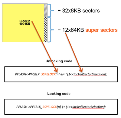

I'm trying to program FLASH of S32K312, for now, it's 32 words from address 0x401000 to 0x40107F (nearly start of "Code flash memory 0").
Communication is done via SWD interface, AHB_AP (DAP master #4). Chip is blank.
PFLASH_PFCBLK0_SPELOCK, PFLASH_PFCBLK0_SSPELOCK, PFLASH_PFCBLK0_SETSLOCK are set to 0.

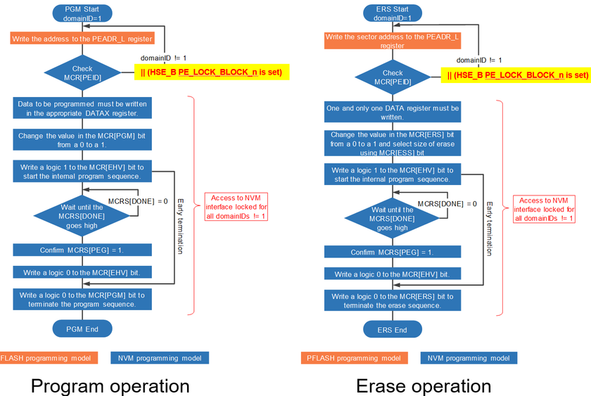

Reading XRDC_HWCFG1_DID gets 0 as domain ID.
PFLASH_PFCPGM_PEADR_L is loaded with address 0x401000.
FLASH_MCRS is written with PES and PEP set to 1 to clear pending errors.
Data are written to DATAX[0]-DATAx[31].
FLASH_MCR is set to MCR_PGM
FLASH_MCR is set to (MCR_PGM or MCR_EHV)
At this point I get FLASH_MCRS = 0x0002C100, meaning PEP bit is set.

Regarding the sectors, if you program 0x401000 to 0x40107F, it is the first super sector in PFLASH_PFCBLK0_SSPELOCK[0].
There are two 1024KB blocks on S32K312.
12x64KB sectors (super sectors) in the first 768KB area of every block.
32x8KB sectors in the last 256KB area of every block.
And this is the programming model, please double-check all the steps.

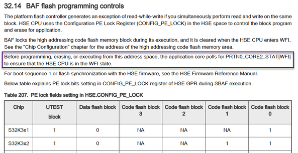

Can you read this register?

I have to mention, that core is halted, in debug.

Hi Daniel,
content of PRTN0_CORE2_STAT is 0x80000001
