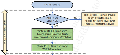

I am working on S32K312 to do SBC FS26 watchdog refresh every 50 ms. I am facing the issue with the InitDevice function, while Initializing the SBC.
Can anyone help me out?

As we know, after power up, wake up from Standby or RSTB assertion, the fail-safe state machine is moving through several states and wait in Init_FS state. In this state, the RSTB pin is released to high level and the MCU must configure FS_I_xxx registers and then perform a good watchdog refresh within 256 ms.
Do you mean that you are not able to perform the first good watchdog refresh?
I hope this information helps.
