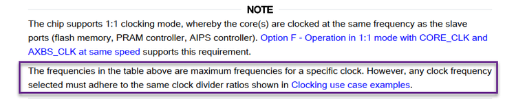

You mentioned that AIPS_PLAT clock is set to 40MHz.
Seems like you selected your own clock configuration, becasue in
Table 148. Option B - Reduced Speed mode (CORE_CLK @ 120 MHz), AIPS_PLAT is 60MHz.
Table 150. Option D - Low-Speed Run mode (CORE_CLK @ 48 MHz), AIPS_PLAT is 48MHz.
We recommend using one of the clock options, becasue they have been validated, all the clocks should be set to the corresponding values.
If you decide to use your own clock configuration, it must be within the Table 145. System clock frequency limitations.
And the divider ratios between the clocks must follow one of the clock options mentioned above.
Below table 145, you can read:
If the clocks do not follow the restrictions, we can't guarantee the specified functionality of the MCU.
