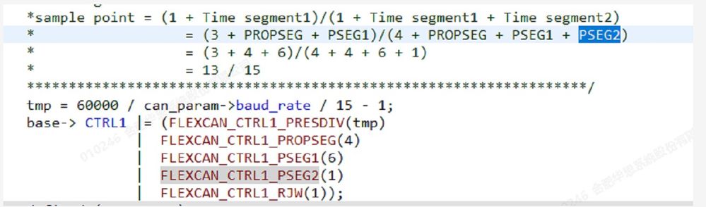

We encountered the following problem: Our CAN sampling point calculation method is shown in the following figure. Currently, we are equipped with 13/15=86.6, but the actual sampling points measured by CANOE between 90.3% to 100%, with a significant deviation. May I ask if there is any problem with my calculation method?Or are there any other points to pay attention to?

Hi@Ali22
Please tell me your flexcan's clock setting, and the baud rate , sample point you want get, and i will give you some reference.

We want sample point is around 0.87

After calculating with the tool you provided, the result is the same as before. What I want to know is that the sampling point I calculated was 86.666%, but the actual test value exceeded 90%. Is this deviation considered normal?

Hi@Ali22
I think the calculation method here is correct. This may be caused by clock errors and test errors.
I suggest switching the FLEXCAN module clock to an external crystal clock, reconfiguring it, and then testing it again.(Because the error of the external crystal clock is usually very small)

CAN clock is 60MHz, Bitrate is 500K, Thanks.
