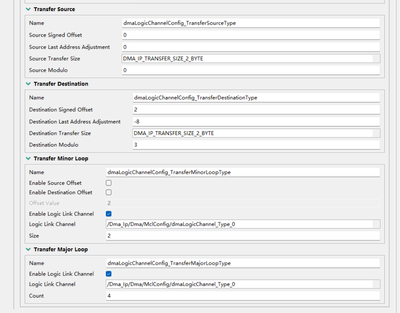

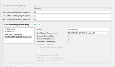

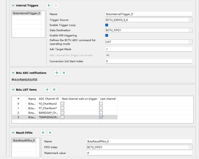

I wanted to use the S32K312 to configure three or four ADC channels and DMA them into an array, expecting the first three or four elements of the array to represent the ADC values of each channel, but no matter how I set it, I couldn't get the results I wanted. Please tell me how I can set the signed offset of DMA source and destination. last address adjustment, transfer size and modulo and minor loop size major loop count.
The following attachments and pictures are my setup pictures and works (four ADCs).

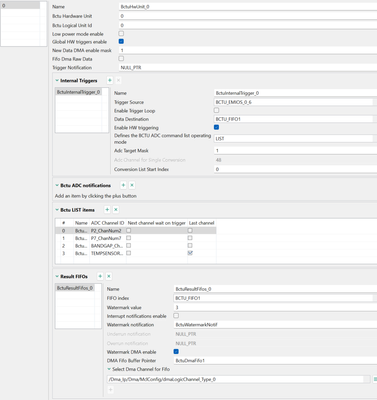

driver is setting up DMA channel in case RXFIFO is used, user need to only enable global DMA config and point to right DMA callback. I did a few modification in setting as below and with attached main.c results are updating.
PetrS_4-1732885095486.pngPetrS_5-1732885103053.pngPetrS_6-1732885111168.pngPetrS_7-1732885118539.png
Hope it helps.
