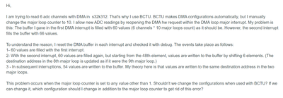

Since my posts were detected as spam, I explained the problem with a screenshot.

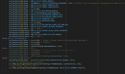

if you really want to modify driver code, which is not recommended indeed, below changes should be enough to fill buffer 10times
LocTransferList[7].Value = (uint32)(10U);  // 10 minor loops
LocTransferList[8].Value = ((uint32)(~(10*(uint32)(LocTransferList[6].Value)) + 1U)); // final dest address adjustment -(10*24)

so BCTU triggers 6 conversions, DMA is used to read it from data register/FIFO, and you want to repeat that 10times to fill 60 values buffer? Am I right.
It could be great you share a config you have and code used, to check that.
I assume, if BCTU driver is configuring DMA transfer somehow then you should not modify it. For example in RTD 3.0.0, such repetitive transfer is not configurable, I think, unless driver is modified.

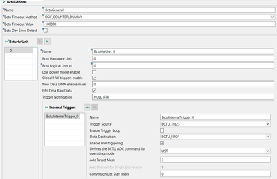

Yes, you're right. BCTU configurations:
And bctu's DMA configurations: (BCTU uses the Bctu_FifoSetupDma function)
As I said, just changed major loop count to 10. Also, I update the destination address and hw request enable configuration at every major loop interrupt.
