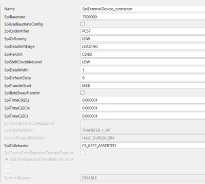

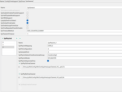

nirmal_masilamani
Hello @VaneB ,
Below images are my SPI 0 configuration.
I am using Custom board.

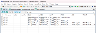

After analyzing, SBC and Pressure sensor connected in LPSPI0.
SBC -> PTB5 (PCS0)
Pressure sensor - > PTA7 (PCS1).
Whenever I configure both CS pins, SBC resetting MCU continuously.
Is there any restriction to use both pin as SPI at same time? Because if i configure PTA7 as GPIO, there is no issue.

If i configure different pin as PCS1 ( PTC6 OR PTD5  ), no issue. Working fine. Issue is only with PTA7 pin as SPI 0 PCS1.
Even if i configure PTB5 pin as GPIO and PTA7 as SPI 0 PCS2, same issue. SBC resetting MCU.

VaneB
Hi @nirmal_masilamani
Your project configurations seem correct. I have one observation: according to the data you are transmitting, you need to change the SpiDataWidth parameter in ConfigTools from 1 to 8.
As I am unable to reproduce your issue, the most likely root cause might be related to hardware. Unfortunately, it is complex to determine the specific cause since you are working on a custom board, while I am working on an S32K31XEVB-Q100.

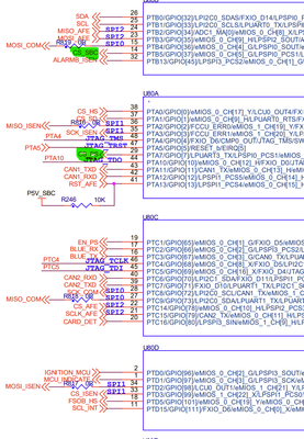

nirmal_masilamani
Hi @VaneB ,
i have attached our schematic details for SBC and Pressure sensor.
Please let us know if there is some wrong connection in the schematic.

VaneB
Regarding your request to review the schematic, I wanted to let you know that, unfortunately, I am not an FS23 expert. To ensure you get the best assistance, could you please create a new post or submit a support ticket for this review? Please note that submitting a support ticket might be the best option if your schematic contains confidential information.
As previously mentioned, the references I can provide are the Hardware Design Guidelines for S32K3xx Microcontrollers and the S32K31XEVB-Q100 schematic.
