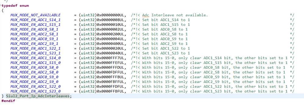

Because the ADC multiplexing mode channel design of the S32K311 and S32K312 is different from other S32K3 series designs, neither the software configuration nor the software driver can implement this function(ADC mux-mode). It is not implemented in RTD4.0.0 and RTD5.0.0.

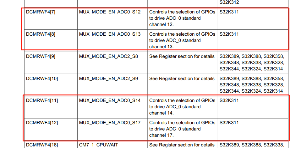

Refer to manual S32K3RM v9 above for the functional description of DCMRWF4.
Using RTD5.0.0 to configure the PTC16 pin, the multiplexing configuration of the ADC cannot be generated, and it is NOT_AVAILABLE
There is also no implementation of relevant macro definitions in the underlying driver.
The ADC input takes effect PTB0 by default. If you want to select PTC16, you need to set DCMRWF4 [11] to 1.
Since the underlying drivers were not implemented, I could only modify the code.
IP_DCM_GPR->DCMRWF4 |= (1 << 11); // PTC16

A few months ago, design team confirmed that the ADC MUX information about S32K310 and S32K311 in S32K3RM v9 is not complete, and gave us S32K311_ADC_Mux_Control.xlsx. The reference manual will be updated in the next version.
I tried to modify the ADC pins in S32DS Pins Tool this morning, but as you mentioned, the macro definitions Siul2_Port_Ip_AdcInterleaves are not defined, so after Siul2_Port_Ip_Init is called, Siul2_Port_Ip_WriteDCMConfiguration will not modify the DCMRWF4 register of S32K310 and S32K311.
I'm afraid that writing to registers is the only option at the moment. I'm asking the AE team when RTD will fix this.
