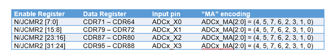

Below is mapping for external channel selection register, data register and ADC input.
You can simply test external channel sampling without ext analog mux connected, for example select ch72 to be sampled, you should have input signal connected to ADCx_X1 input, finally result should be read from CDR72 register.
