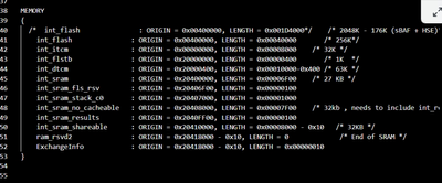

zq1
hello, there is a  question to be wroked out , i want to know ,in S32K312 's link file , if i want to set a flag which is used for app vaild flag   in ram ,and after soft reset,the flag will not clear , i must set the flag in  the standby ram or not?  in demo called unified_bootloader_demo_v2.1 ,i found  the flag was set in the lastest section as blew:
hope your reply ,thank you very much.

HemantKapoor
Hello Lukas,
Many thanks for the response.
I followed the unified bootloader linker file usage and it is also doing something similar,
ram_rsvd2 : ORIGIN = 0x20443FF0, LENGTH = 0 /* End of SRAM */
ExchangeInfo : ORIGIN = 0x20443FF0, LENGTH = 0x00000010
So not sure what I have missed.
