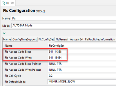

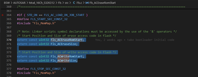

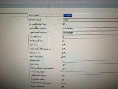

1. According to the referrence manual, we need to enable AC_load_on_Job_Start to avoid RWW problems.
But when I enabled it as below picture, Fls_ACWriteSize and Fls_ACWriteRomStart are still undefined (the same as Fls_ACEraseSize and Fls_ACEraseRomStart).
so how to solve this problem please ?

I did quick test in this version. If the sector which is supposed to be erased is in the same flash block as Fls code, I can see that the code is copied to RAM as expected and the sector is successfully erased. Not sure what's going on on your side...

how should I define these variables?
1,200 次查看
lukaszadrapa
In my test code, I just initialized these addresses in configurator, so it points to unused RAM:
1,186 次查看

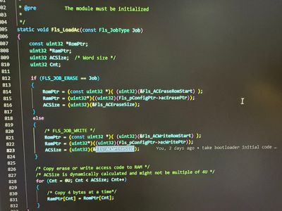

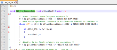

Jojo_Hu
Which parts of the code in ROM will be placed at this address in RAM ?
This function ?
1,171 次查看
lukaszadrapa
Yes, C40_Ip_AccessCode is copied to RAM.

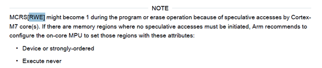

hi,
The memory distribution of Application and Bootloader are as follows.
If we want to erase and write Application while running in bootloader, and Ac load at startup has been enabled, do we need to configure the on-core MPU as mentioned in the second picture in PreTaskHook ?
