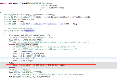

  When I used GPIO to simulate spi's CS, the data was wrong.Can you give me some help?
   In RTD2.0.0,  Lpspi_Ip_AsyncTransmit() calls Lpspi_TransmitTxInit() to initialize the transmission clock and reset. If the (CPOL = 1) mode is used, a low level pulse is generated each time on the SCK. If I use GPIO to simulate the CS pin of the chip, it will be interfered by this low pulse, resulting in abnormal data.

As seen in the Lpspi_TransmitTxInit function, it is necessary to reset all the registers due to errata ERR050456. As you saw, this is generating the low pulse that is interfering.
What I suggest is that you modify this function and send the CS after the reset to ensure that does not interfere with the data.

I am also using GPIO to simulate CS. I am trying to communicate with an external flash which has a flow chart of:
1 - Write command
2 - Read response
during which CS should be low. However, it is impossible in this case since in second step inevitably an extra pulse will be sent.
Is there any workaround for this case?
