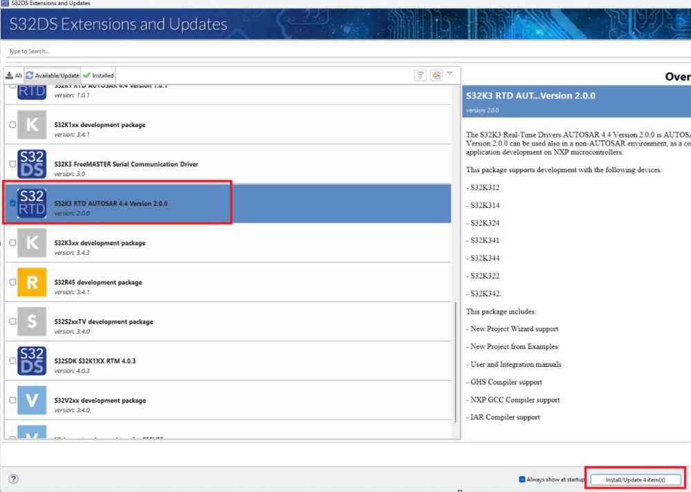

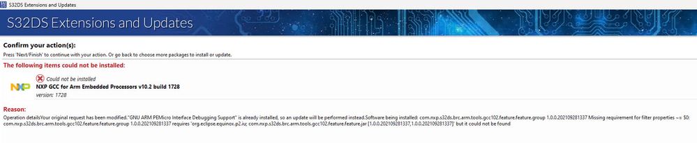

Hi, NXP team,
I am trying to install S32K3 RTD AUTOSAR 4.4 version 2.0.0 into s32DS 3.4. (The purpose is to build S32K344_CAN_Bootloader_RTD2d0, based on:
https://community.nxp.com/t5/S32K/S32K3-Unified-Bootloader-Build-Issue/m-p/1653130 ). But I get an error when trying to install/update as bellow
z6291304657424_c6a27a1f259e82c915dd4cd3827280ec.jpgz6291304272242_46785e6395ba466340ed660eb5278dc1.jpgz6291305070533_fe0ae58efeef8e85e639c738d4f766a4.jpg
Can you help, please

Before installing the RTD 2.0.0, you need the S32 Design Studio IDE v3.4 Update 3. This update include the item which is giving you an error.

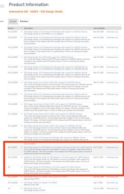

You can found it in S32K3 page -> Design Resources -> Software -> S32K3 Standard Software -> Automotive SW - S32K3 - S32 Design Studio -> Previous:

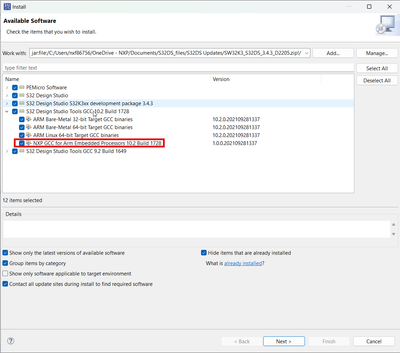

Then install it in S32DS -> Help -> Install New Software

Thanks for your reply, but I can't find v3.4 update 3  in the link. Could it be due to my account limitations? I only see v3.4 update 1
