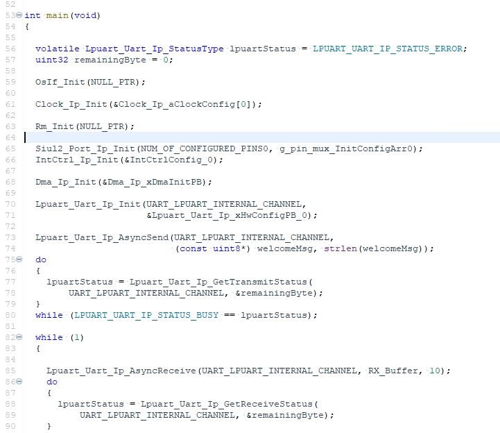

I have implemented interrupt based LPUART sample succesfully. Then I refered to https://community.nxp.com/t5/S32K/S32K3-Lpuart-using-DMA/m-p/1717935#M26818 and https://community.nxp.com/t5/S32K/S32K344-UART-DMA-example/m-p/1583510 to try DMA based LPUART, but I can't send and receive any data.
And I noticed there are some differences between samples and mine. because in my S32DS enviroment, no DMAMUX source setting in DMA_ip->Specific Configuration->Dma logic channel.
My RTD version is 3.0.0 P07, S32DS version is 3.5 Update 6.
May I know how to solve it, Thank you.

I've tried to append Rm module and configured, following is related snapshot, but it dosen't work yet.
BTW: Must I mix MCAL Rm driver and IP driver for my program?  I just plan to use IP driver to implement LPART based DMA, could you have other solution or some sample code?

check if DMAMUX is really configured. You should call Rm_Init with some parameter generated.
Rm_Init(&Rm_Config);
BR, Petr

Hello Petr,
I confirmed DMAMUX configured and modified Rm_Init, from Rm_Init(NULL_PTR) to Rm_Init(Rm_Init(&Rm_Config_BOARD_INITPERIPHERALS), but it dosen't work well.
From Line 82 to 92, I can see output in my Serial Tool,  but lpuartStatus is still  LPUART_UART_IP_STATUS_BUSY continuously.
Attachment is the latest code, could you help me to check what't wrong?  Thank you.

PetrS
I tried your first project and after few modification it seems to be running.
It sends welcome message then waits for 10bytes and echoes them back finally.
BR, Petr

nhyjq2000
Hello Petr,
It works well in my computer. Thank you very much.
