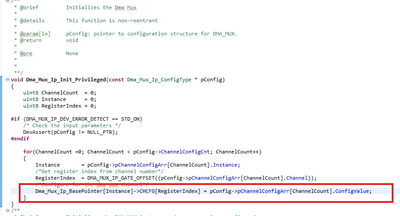

543件の閲覧回数
iverson3ya
I used the example you provided and changed it to UART1, but when running the initialization, it crashed at the point shown in the image below
