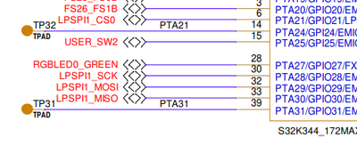

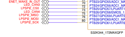

I noticed that the SIN and SOUT pin assignments differ between the schematic and the project’s pin configuration. To avoid issues, I went with the pinout as shown in the schematic.
Is the schematic considered the correct reference in this case?
DiaDev_0-1748839248683.pngDiaDev_0-1748839248683.pngDiaDev_1-1748839277634.pngDiaDev_1-1748839277634.png

Hi @DiaDev
Based on the schematic, here is how I understand the connections:
Signal Slave (LPSPI1) Master (LPSPI2)
PCS0 PTA21 (input) PTB25 (output)
SCK PTA28 (input) PTB29 (output)
MOSI PTA26 (input) PTB28 (default: input)
MISO PTA30 (output) PTB27 (default: output)
As we can see, the pin setup on the master side does not match the default SPI configuration. That is why, as previously mentioned, you will need to modify the LPSPI->CFGR1[PINCFG]register.
You have two options:
1. Update the PINCFG register to change the default direction of PTB28 and PTB27, so PTB28 becomes an output (MOSI) and PTB27 becomes an input (MISO), matching your intended configuration.
2. Swap the signal roles so that PTB28 is used as the master input (MISO) and PTB27 as the master output (MOSI). This way, you can keeo the default configuration and avoid changing the PINCFG register.
5,946 次查看

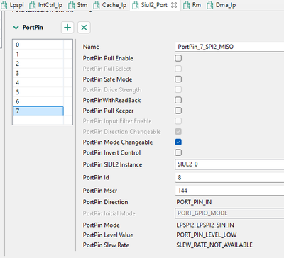

I see a variable named "PortPinMscr". Where can I find the number corresponding to LPSPI? Is there any documentation for this?
Also, is it necessary to configure the port (using the Port module) for LPSPI communication? Is port configuration required for the LPSPI master and slave to communicate properly?
5,911 次查看
VaneB
Hi @DiaDev
The "PortPin MSCR" is a numeric value representing the Multiplexed Signal Configuration Register. It can be calculated using the following formula:
PortPinMscr = PinId + (PortId × 32)
Where:
  • PortId is the numeric identifier of the port (e.g., PortA = 0, PortB = 1, PortC = 2, etc.).
  • PinId is the index of the selected pin within the port.
For example, for PTB0, the calculation would be:
PortPinMscr = 0 + (1 × 32) = 32

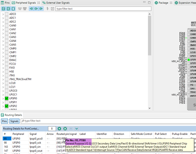

Additionally, if you place the cursor over the "Routed pin/signal" column in the Pins Tool, this value will be displayed along with other relevant information. Please refer to the image below for a visual reference.
Lastly, yes, it is necessary to add and configure all the used pins in the Port Driver to ensure proper peripheral functionality. This driver is responsible for initializing the entire PORT structure of the microcontroller.
