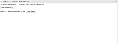

S32K344 使用Jlink  debug , 无法访问 0x20000000 地址内容

...Target halted (PC = 0x20000008)

...Target halted (DBGRQ, PC = 0x20000000)
Reading common registers: Read register 'r0' (4 bytes) from hardware: 0x9C793300
Read register 'r1' (4 bytes) from hardware: 0xFFFFFFFF
Read register 'r2' (4 bytes) from hardware: 0xEFBEADDE
Read register 'r3' (4 bytes) from hardware: 0x000000C0
Read register 'r4' (4 bytes) from hardware: 0x00E000E0
Read register 'r5' (4 bytes) from hardware: 0x00000000
Read register 'r6' (4 bytes) from hardware: 0x00000000
Read register 'r7' (4 bytes) from hardware: 0x00000000
Read register 'r8' (4 bytes) from hardware: 0x00000000
Read register 'r9' (4 bytes) from hardware: 0x00000000
Read register 'r10' (4 bytes) from hardware: 0x00000000
Read register 'r11' (4 bytes) from hardware: 0xB80A4020
Read register 'r12' (4 bytes) from hardware: 0x68004020
Read register 'sp' (4 bytes) from hardware: 0x00000220
Read register 'lr' (4 bytes) from hardware: 0xF74B4000
Read register 'pc' (4 bytes) from hardware: 0x00000020
Read register 'xpsr' (4 bytes) from hardware: 0x03000081
Removing breakpoint @ address 0x00400EB0, Size = 2
Read 4 bytes @ address 0x20000000 (Data = 0x2202E8E0)
Read 2 bytes @ address 0x20000000 (Data = 0xE8E0)
Read 2 bytes @ address 0x20000002 (Data = 0x2202)
Read 4 bytes @ address 0x00404BF6 (Data = 0xFFFFFFFF)
Reading 64 bytes @ address 0x20020000
WARNING: Failed to read memory @ address 0x20020000
WARNING: Failed to read memory @ address 0x20020014
Reading 64 bytes @ address 0x20000000
Reading 64 bytes @ address 0x1FFFFFC0
WARNING: Failed to read memory @ address 0x1FFFFFC0
WARNING: Failed to read memory @ address 0x1FFFFFFE
Reading 64 bytes @ address 0x20000040

我也遇到了同样的问题,现在有解决吗
908件の閲覧回数
yxe90
我使用的是SWD 调试接口,除了正常的四根线外,必须加上JTAG的RESET脚链接到MCU RESET脚上。
