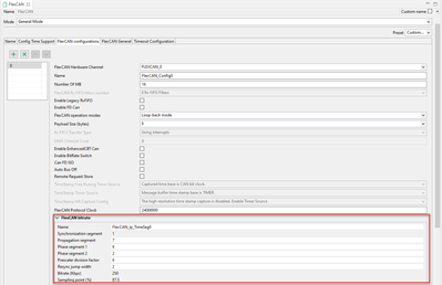

Hi @EvaKi,
You can change the FlexCAN bitrate through the configuration in peripherals:
Chapter 73.3.10.8.1 from the S32K3XX's Reference Manual explains the timing parameters required by the CAN protocol. You can also use the following community post for CAN bit timing calculation: MPC5xxx/S32Kxx/LPCxxxx: CAN / CAN FD bit timing calculation - NXP Community.

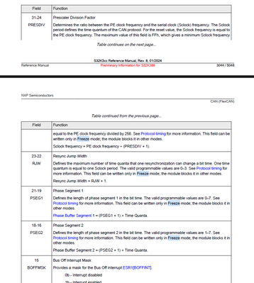

Julián_AragónM
Hi @EvaKi,
Chapter 73.6.2.3 Control 1 (CTRL1) from the Reference Manual specifies that these CAN bit timing variables can only be modified in freeze mode. They cannot be changed in runtime:
Julián

EvaKi
@Julián_AragónM
Sorry for taking so long to reply
For changing CAN bps, I use the FreezeMode. but it can be only effect on rise CAN bps.
such as: 250Kbps -> 500Kbps, it is ok.
250Kbps -> 125Kbps, it's not ok
void can_SetBitrate( uint8_t bitrate )
FlexCAN_Disable( IP_CAN_0 );
FlexCAN_Ip_EnterFreezeMode_Privileged(INST_FLEXCAN_0);
FlexCAN_Ip_SetBitrate_Privileged(INST_FLEXCAN_0,&can_pall_config[bitrate],FALSE);
FlexCAN_Ip_ExitFreezeMode_Privileged(INST_FLEXCAN_0);
FlexCAN_Enable( IP_CAN_0 );
