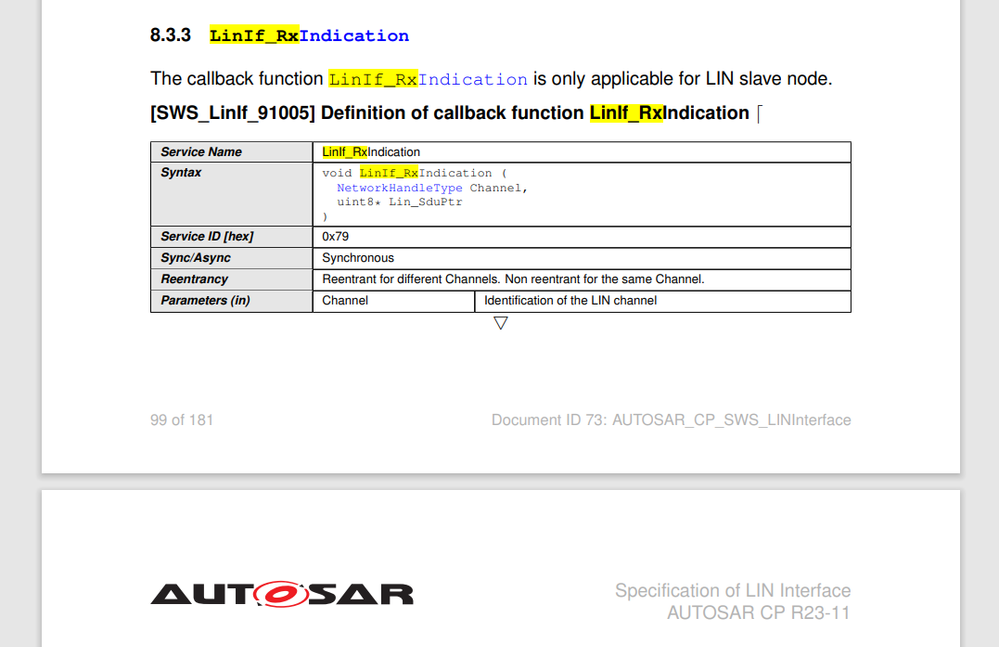

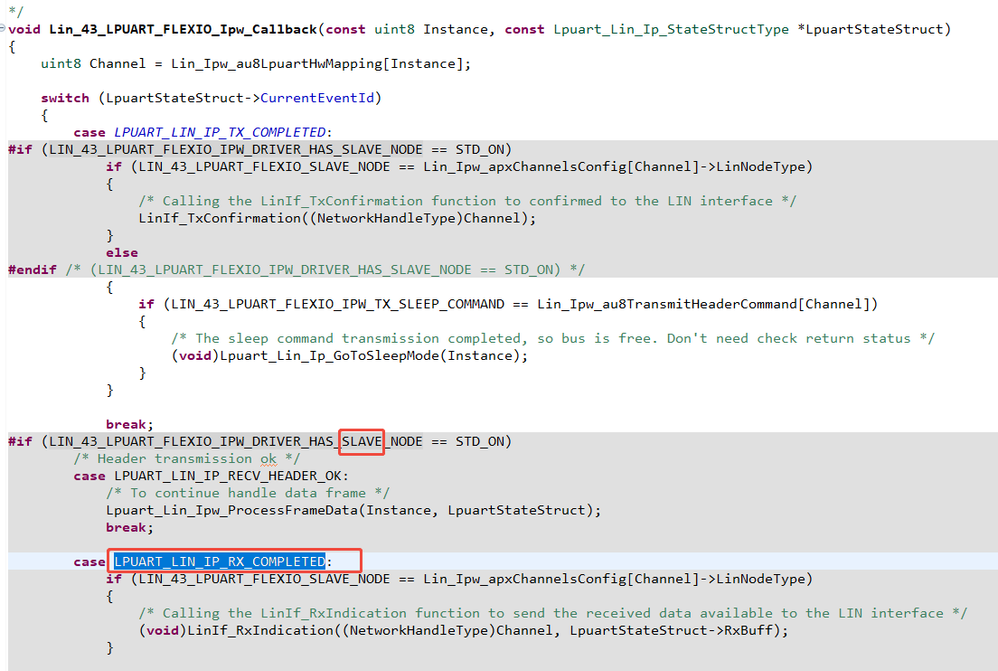

When LIN is the master, in the interrupt function, there is no relevant API to notify the user, and the response data of the slave cannot be obtained in time. LinIf_RxIndication can only be used in slave mode.

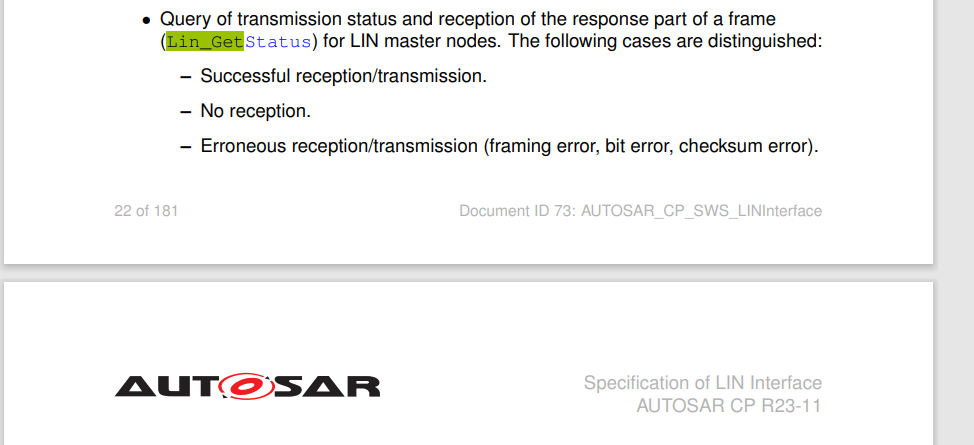

I can only get data through Lin_43_LPUART_FLEXIO_GetStatus. Is there a better way?

The function LinIf_RxIndication is only applicable for slave nodes because is an AUTOSAR standard indication.
The standard also mentions that Master nodes have to use the Lin_GetStatus()
This is the indication of AUTOSAR for automotive implementations and our drivers are based on that. So, this is the better way to obtain data of a LIN Master Node.

Seems that you are using LIN STACK.  You are right, the LinIf_RxIndication is for slave.
* @brief The LIN Driver will call this function to report a successfully received response and
* provides the reception data to the LIN Interface. This function is only applicable for
* LIN slave nodes (available only if the ECU has any LIN slave channel).
* @details This is a function stub only.
* @Param[in] Channel Identification of the LIN channel.
* @Param[in] Lin_SduPtr Pointer to pointer to a shadow buffer or memory mapped LIN Hardware receive
* buffer where the current SDU is stored. This pointer is only valid if the
* response is received.
* @Requirements
void LinIf_RxIndication(NetworkHandleType Channel, const uint8* Lin_SduPtr)
I need to consult this with SW team and will update this thread as soon as I have their feedback.
