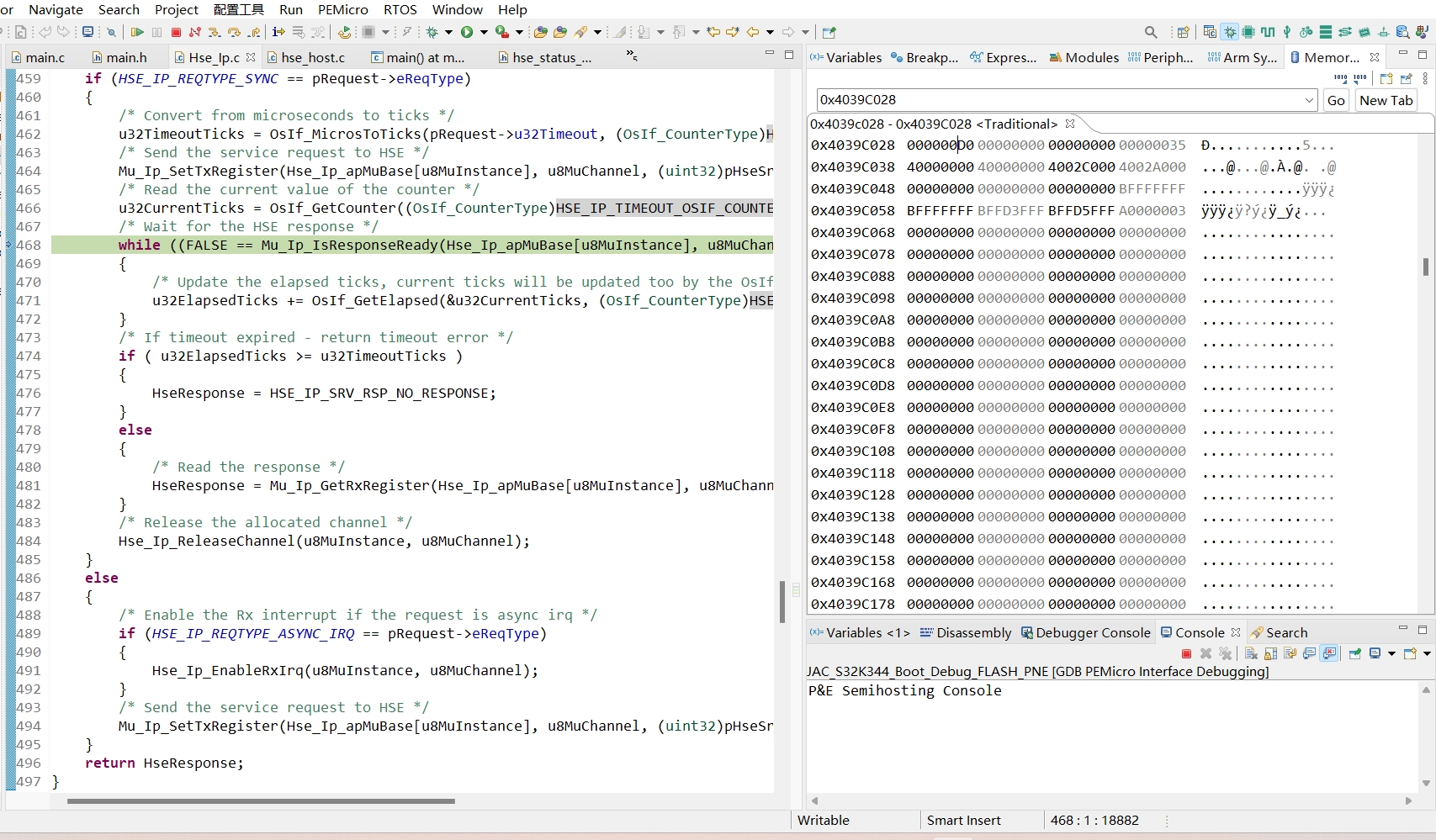

1,853 Views
ALXY_WANG1
Now that I have normally integrated the relevant interface software of HSE here, when I try to obtain the version number service of the HSE module, it has been stuck at the response timeout section. I can obtain the version number by using the HSE sample file. Could you please tell me what the possible reasons are?
1,827 Views
lukaszadrapa
Once you get the timeout error, what is the content of FSR and GSR registers in MU0? And what can you see in HSE GPR register at 0x4039_C028?
Is the data cache disabled?
Lukas
1,786 Views

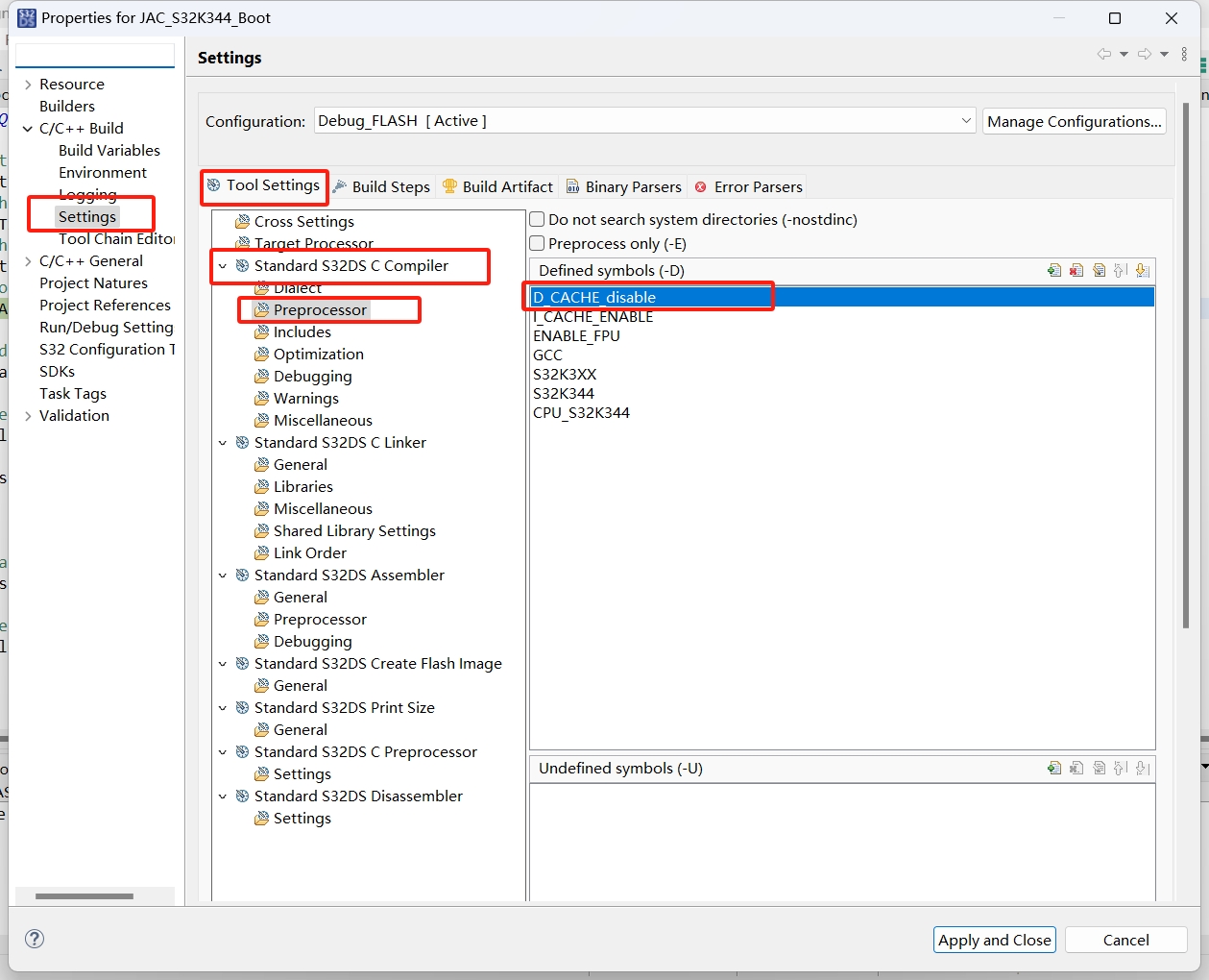

ALXY_WANG1
As shown in the figure, the attached value is 0x4039C028 read by the runtime memory. Meanwhile, the D-cache function is disabled through the RTD Startup Procedure.
1,763 Views
lukaszadrapa
According to HSE GPR register at 0x4039_C028, the firmware is NOT installed.
