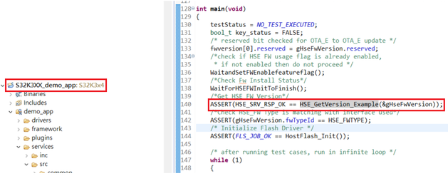

I have installed HSE A/B swap firmware on S32K324.
And running the official S32K3XX_demo_app can read the HSE firmware version.
If I can read the HSE firmware version it means HSE is running, right?

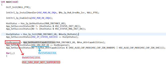

I want to use RTD HSE module to operate HSE, so I create a new S32K324 project
I refer to the S32K344 HSE sample program to setting my new project
(sample code:Hse_Ip_AesEncAsyncIrq_S32K344)
(setting inculde: RTD setting, main loop application)
However, when the program is executed to App_GetHseAttrCapabilities() to read the HSE version.
The Function return HSE_SRV_RSP_NOT_SUPPORTED(0xAA55A11EUL)
What's the problem? What settings can I check?

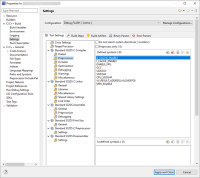

it could be caused by cache memory. It is important to force descriptors/data sent to/from Messaging Unit to non-cacheable region. To check if it is related to the cache memory, you can try to disable the cache by DC bit in core register CCR Configuration and Control Register.
Or go to the project properties and remove D_CACHE_ENABLE:

Hello Lukas,
Thank you very much for your immediate reply and support.
This solution is effective.
