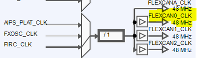

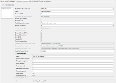

Im trying to set up the CAN on S32K3, I did not found an example based on polling (not interrupts), using RTD and no Autosar, I did the following config :
Pins used are PTA28 – PTA27 (CAN-0)
Standard CAN with 500Kb – 8 bytes payload
Clock for CAN enabled
FlexCan_Send function will execute successfully only once, after that the bus goes into busy state and will not transmit any CAN frame, after adding   FlexCAN_Ip_AbortTransfer seems to work, but im not sure if this was the correct approach ?
