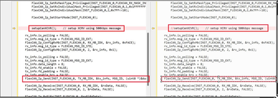

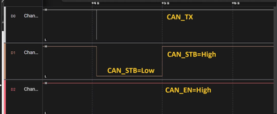

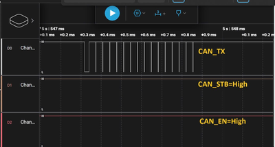

 Hi NXP team,
Can i ask why there is a difference between calling and not calling setupCanXCVR()
After calling this function, my CAN_TX pin no longer emits Digital signal
Call setupCanXCVR()
Notcall setupCanXCVR()
Why does this difference result in the function FlexCAN_Ip_Send(INST_FLEXCAN_0, TX_MB_IDX, &tx_info, MSG_ID, (uint8 *)&dummyData); not working properly?

Senlent
Hi@Voledi
This code is used to configure the TJA1153 CAN transceiver. If the transceiver you are using is not TJA1153, this code is completely unnecessary.

i'm using S32K3X4-Q172 EVB, and the transceiver used is TJA1153. Base on Example S32K344 FlexCAN_Ip TX/RX/EnhanceRXFIFO test S32DS3.4 RTD200 - NXP Community
1,031 Views
quangvuanh
Hi, this is a known issue of TJA1153 that we have to clear the vanilla configuration of before reconfiguring the device, it requires some time constrains.
I migrated the example to the latest version of the RTD, with some modifications, please try and let me know if it could resolve your problem.
